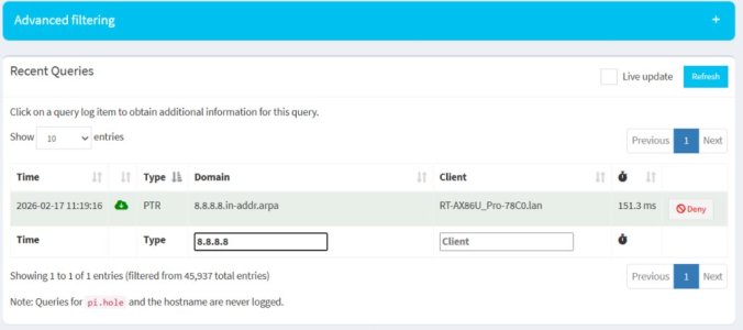

Not sure I've seen such behavior with the Asus-Merlin 3006.102.x firmware with DNS Director + Pi-Hole (on a Raspeberry Pi device) + Unbound. The Pi-Hole diagnostics log shows the requests from hard coded DNS entries on the client device as coming from the router (which it should per the DNS Director settings). But then again I do block Google's DNS's (8.8.8.8 and 8.8.4.4) using the LAN > Route page:
Generally how I have my Pi-Hole, RT-AX86U Pro router, Guest Network Pro, and DNS Director configured is detailed at the following post:
Windows test:
nslookup google.com 8.8.8.8
→ Works
As @dave14305 indicated, does a nslookup google.com 8.8.8.8 request show up in your Pi-hole Query Log?
With my previously described Pi-Hole DNS Director (and Route) settings this is how my Raspberry Pi Pi-Hole (with Unbound) shows that nslookup request:

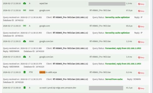

A second example, this time with the LAN > Route disabled (that was used to route 8.8.8.8/8.8.4.4). Second query is highlighted in red.

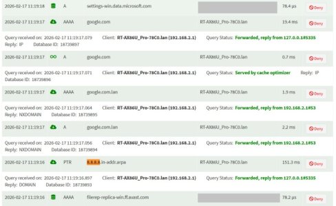

Where is the actual google.com query?

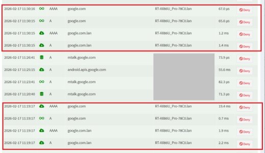

Here are the two sets of time for the google.com that are similar to the previously posted 8.8.8.8 query. The 11:19:x time was with my LAN > Rules enabled and the 11:30:x time is with LAN > Rules disabled.
Edit to add: Bit more information in additional screen shots of the Pi-Hole Query Log.
11:19:x time:
11:30:x time:
EDIT: Included an incorrect screenshot for the pihole logs. Added the correct one.
