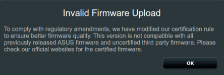

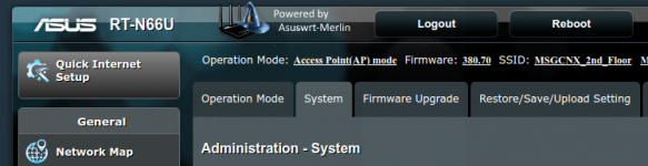

I have a N66U. Still running 380.7 Merlin. I have tried updating to this fork but get the following error.
Using Chrome/Kubuntu 20.04.1
I would have thought 380.7 was before the new checks, but apparently not. Try loading via the recovery tool or CFE mini web server.
There is no 380.7, this must be 380.70.
