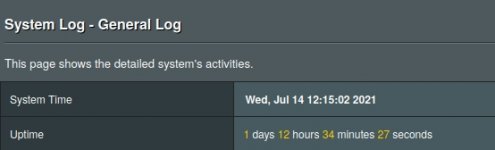

[blush] Did that, and after 36 hours - no reboot. Will wait for a few days, just to be sure it won't restart after 56-60 hours, like Rahul_K mentions. Thanks.
