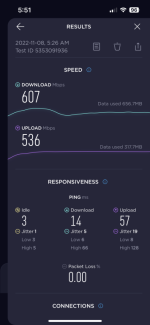

3- The Wi-Fi seems to work very well and worked very well when I had 400/50 (now have 1.5G/1.0) - I just tested one end of the unit (it's long not square) and was getting 607/536 vs 451/55 from the previous ISP. I have attached a photo of the previous ISP's modem
4- I actually don't know how it's set up, it's got a weird "user-friendly" interface but I basically went into the Sagemcom's settings and turned off all the Wi-Fi radios. The AX86U is handling all the routing but is connected through the ethernet to this router as it was to the previous one.
5- My goal is to maximize the responsiveness of the system and since many of my devices are wired (main computer where I game, Apple TV where we do much of our streaming, upcoming XBOX or PS5 that will also be wired), I want to maximize wired performance too. Furthermore, the home is used as an office for 2 people where large file upload and heavy video calls happen also (2 to 300 people meetings with screensharing etc.): the work laptops are on Wi-Fi 6.
