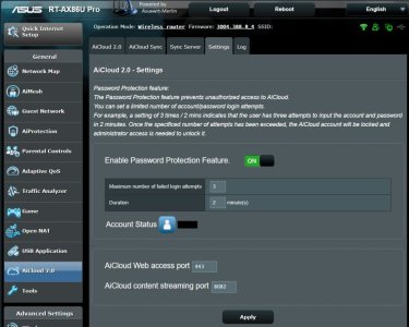

So am I right this setting is automatically enabled and ok to leave it at that? Never used AiCloud before or even navigate to that page. Behind CG-Nat anyway.
Seems like you've had plenty of responses but none directly answering your question. I am fairly certain that the setting in your screenshot is a default as my router is the same and I've never used AiCloud. Based on that my answer to the second part of your question is that it's ok to leave it that way.
Yes. In Asus-Merlin the Enable Password Protection Feature default setting is enabled/on even when one doesn't have any other AiCloud 2.0 features (Cloud Disk, Smart Access, AiCloud Sync) enabled.
Thank you both, hard to get straight forward answers lately.

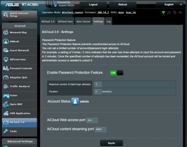

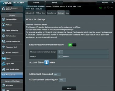

On two RT-AC68U's,
Hopefully all these feedbacks will be useful for @RMerlin going forward.
On two RT-AC68U's, one running Asus firmware the other running Asus Merlin, both default having that setting set to enabled/On with AiCloud disabled.
