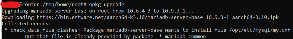

Hi. I have the AX88U with the latest firmware from Merlin, but I have noticed that I cannot resolve one update for mariadb. I use normally amtm to check for updates, but I even had to use opkg update/upgrade. This is the error which I got:
I cannot add the code since the forum is always giving me the error. Added the picture.
Any help would be appreciated.

Try removing mariadb-common as that package is no longer present in the repository, so presumably it's obsolete.

I suggest you remove all currently installed mariadb packages and start again.
opkg list-installed | grep mariadb
