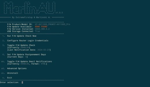

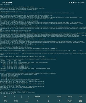

I changed the default settings & did f/w option check now (option 1).
I wasnt sure what HSTS notification is at the top but other than that....all running smoothly!
Just wanted to report the recent firmware updated without any issues.
Thanks for the great work on this!
All looks good and normal to me! Thanks for testing!
