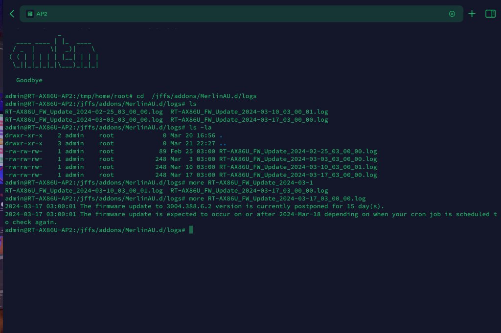

I am seeing this message Cron job hook already exists in ‘/jffs/scripts/services-start’ script repeatedly on both the AP devices. On my main router, I’m not seeing any MerlinAU notices.
Hi @vlord FYI I think we found the bug for your case, the code used to say:
if [ "$((currentTimeSecs - notifyTimeSecs))" -gt "$postponeTimeSecs" ]
So basically it had to be greater, "equal too" was not valid.
After the updates, it will be:
"if [ "$((currentTimeSecs - notifyTimeSecs))" -ge "$postponeTimeSecs" ]"
The sneaky thing went right over my eyes. This will allow equal values, and this will be addressed in PR 168 and be in release 1.0.9 along with better messaging around the cron jobs to clarify the timing expectations. :)
(For things like time changes that happened on the 10th, etc)
Thanks for reporting!

Perfect, so we know the postpone period does not cause any issues when running interactively. This cron job hook already exists message is normal. You will see it everytime the script runs, both interactively in the SSH session or by cron job.
The last one seems to be happening pretty often, did you turn up the cron job schedule? Or run MerlinAU multiple times by chance over SSH?
Can I please have a screenshot of the MerlinAU notification date, in the Addon GUI over SSH please as requested above? Actually can I have a screenshot of all your settings to replicate.
Also, if you haven't tried, can you try to turn the cron schedule up to something soon? Like every 10 minutes, and monitor to see if the cron has the issue again?
