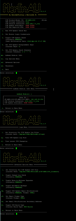

Significant screenshots:
1716136275487-png.58802
