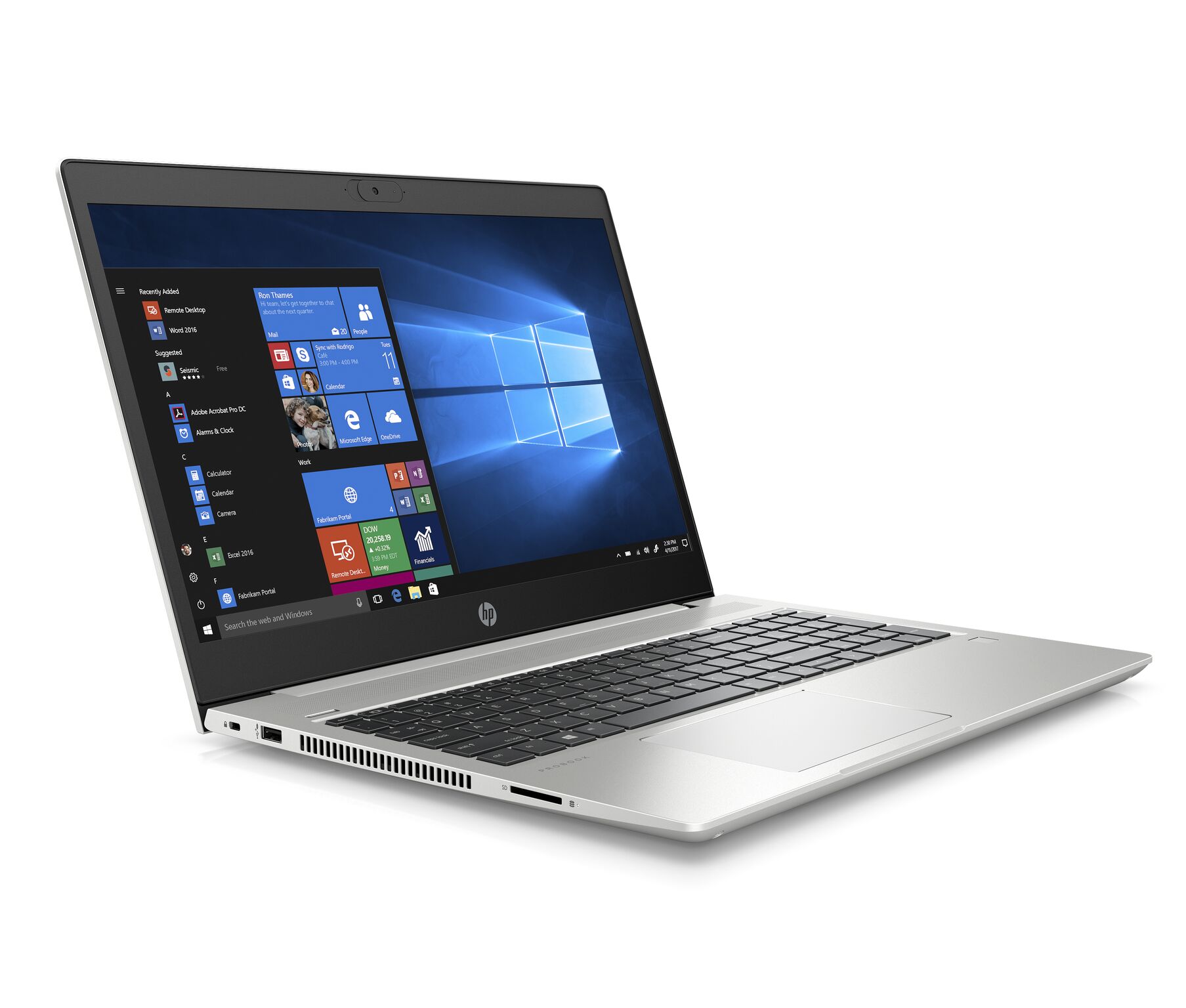

this is a good reason why auto-update is not a good thing...
I would rather leave auto-updates in the capable hands of @ExtremeFiretop and @Martinski than the clowns running HP. These guys have done nothing but bent over backwards building protections upon safeties upon grepping release notes upon sending email notices/warnings, to ensure that the user is fully aware of the update that's about to get loaded... which is being loaded through the same exact methodology as hitting that "upload" button on the firmware update page... many times DAYS after the release has already hit, so you can stop any potential "bad" firmware update before it gets loaded. How often has that happened. Right?
Yeah, but this actually made it through the folks that run Windows Update - so MSFT has a bit to blame here.
I've always been good with auto-update notifications and let the user decide to do the upgrade or not - give them a couple of days - much like Android or iOS updates - I usually wait a couple of days before pulling the trigger...
With the thousands of vendors that are constantly pushing driver updates through Windows Update every week, I sincerely doubt Microsoft has any say or manpower to even go through proper testing of all that software/firmware matched to very specific hardware. I bet they are counting on the actual hardware/software vendors to have done their due diligence in ensuring firmware was tested on their own hardware. Microsoft is just the delivery vehicle to get it disseminated.
I'm glad you practice safe auto-updating... MerlinAU definitely seems to practice this same methodology. Although, I usually get a bit antsy as I'm always a day-1-release-lock-and-load-and-let-it-fly kind of guy when it comes to Asus firmware. ;)
Something tells me you've never been thru WHQL certs - this applies to drivers and firmware updates that are made through Windows update.
You're missing my point though - I'm totally ok with notification and even 1-click updates by the end-user...
auto-bricking devices is never a good thing...
There was a recent event where a class of carrier devices where bricked...
and even Apple has had issues with auto-bricking due to pushed updates.
This is comparing apples to oranges because here (in this thread) we are talking about the risks of update method. Not the updates the themselves.
Windows update didn't brick those devices, the updates did.
No one blames Windows update for those bricked devices, they blame the updates pushed down through Windows update, no one asked for Windows update to be redesigned due to the bricks, they ask for the drivers and updates to be fixed and pushed down again.
In this example, MerlinAU is Windows update, that would be a proper comparison. The risks involved of the updates being pushed down is a different debate.
