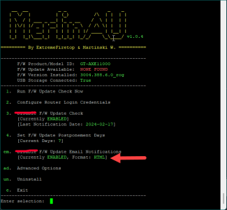

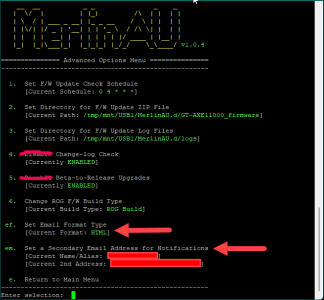

Good work, a small suggestion, for more clarity, get rid of those "disable" words.
Just name the function.
Thanks for the feedback and suggestions! It has been received :)
