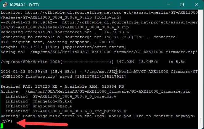

So I'm gonna go with a triple pronged approach to this problem.
1. I'm implementing a passive changelog verification in dev as found below:
This will do a few things for us.
It will give us a little piece of mind that if someone is completely clueless and not paying any attention at all, that it will check for very obvious red flags and advise.
This will prevent users from claiming they "didn't know what they were getting into" with any given update.
The red flags phrases it will search for are:
- features are disabled
- factory default reset
- break backward compatibility
- must be manually
- strongly recommended
I've selected those phrases as I've identified a pattern in the general language used in the changelogs as found here: https://www.asuswrt-merlin.net/node/10
and here: https://www.asuswrt-merlin.net/node/11
If you do a control + F search on both these pages for the phrases above, you'll find it's very specific in every case, and usually something the user should be aware of before flashing.
Why am I using whole phrases? Because I don't want to be too restrictive, the script won't care about specific words like "strongly" or "recommended" it cares about "strongly recommended"
Finally, it will give RMerlin some passive control over this script. (if he so chooses...)
If I implement something like "strongly recommended" RMerlin may decide to actively use it as a feature if he knows it exists. Worst case is he doesn't, then it's just a passive listener in the changelogs incase he uses the same language someday. (Like he as in the past.)

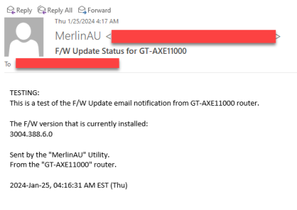

The request for email notifications is completed:
Assuming a user has setup email credentials in AMTM, how about an email notification after an update?
And also before...
"Starting flashing firmware..."
If we don't receive the "update done" email after a couple of minutes, we know that something went (terrible) bad 🫣😁

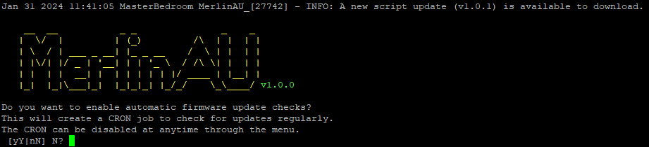

Does it always add it to cron, when you update? Guess I can hit No.

For the Upgrade:
So hit N and it show as CRON job was disabled, but listing the CRON jobs it shows up. Like it does above, so guessing if you set a custom schedule and hit Y, does the default schedule overwrite your custom one?

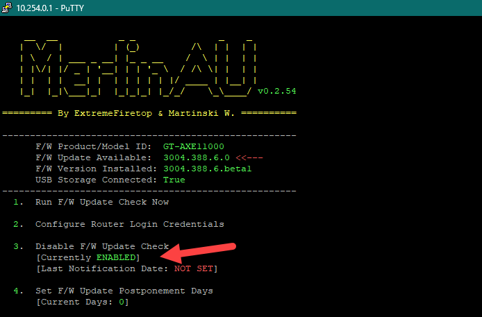

Were you on the "pre-release" version of 0.2.54? If so that explains it as the cron was updated and is likely not being recognized.
My recommendation would be to cleanup the old cron and let the script re-create (enable) it again.

No worries, let me dig up the old PR, do let me know if you were on the pre-release version though!
I was on 1.0, and I hit No and then renabled it, on the first node I hit Y and it was also on 1.0.
Waiting on the next Alpha/Beta/Release cycle to instal it on the Router
And sorry, I totally missed this question.
Yes if you hit custom schedule it updates/overwrites the existing cron :)
