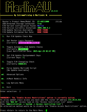

Thank you for clarification - I needed one before art bellow :cool:. Here all is:
and the result:
EDIT: if the warning message in red and fix with 2nd line is implemented as per exact message wording - the functioning is correct from user's perspective, see below:
and the result:

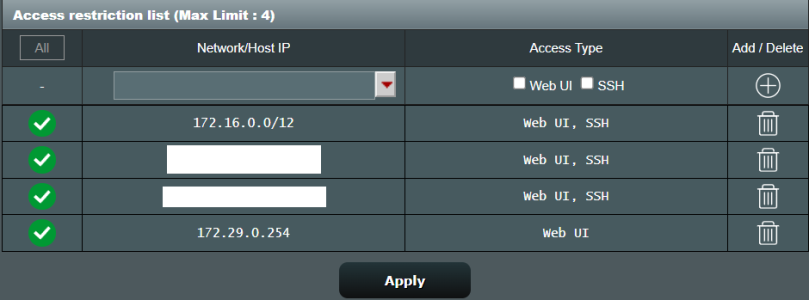

I need examples, what does this mean? In your screenshot all you provided was one range where the router was available and that range is now functional.
If you have overlapping ranges that would be an important detail you've been missing out
concrete access exception CIDR range matches router IP range from mathematical (as seen from ASUS/Merlin firewall) POV, but from MerinAU script POV begins "lower" than (in principle <> 'not equal') router IP or subnet, to which this router IP belongs.

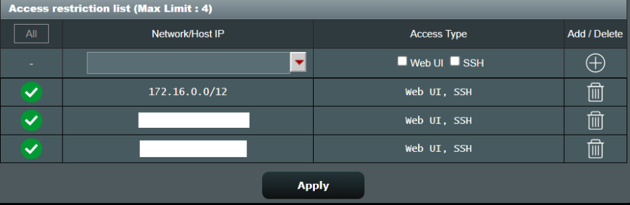

This is lots of info; but unfortunately it's not really clear/useful what point your trying to get across.
Can you provide me with what you mean by "overlapping"? do you mean this?
Have you confirmed or validated that the issue is caused by "overlapping" ? What if you stop overlapping ranges?
Does things start working?

I think just managed to re-create your issue. Seems to actually be within the _CIDR_IPaddrBlockContainsIPaddr_ function.
I think it might be possible the function is failing due to integer overflows with 32-bit arithmetic? Will try to adjust for 64-bit arithmetic and using awk.
If that is correct it would be a similar issue to our cron-job "time calculator" we originally had some problems with.
Will investigate a bit more in the weeds now.

Your example from IP's / DHCP admins way is a bit overkill, but yeah - ^^^^ up here is an obvious example.
My thinking was, if you are making so much validation code changes behind the factual output to the GUI - why not take a scenario, where the validation script, besides stating the router's factual IP, would print out to the GUI the validation confirmation in any case - both wrong or right?
I mean - up to all 4 (max 4!) ranges - separate lines, and validantion result: "router IP [not] in range."
In these days, when even soon-to-be grandpapa's can in principle configure a router restriction, it would make it obvious if there is an error or not.
