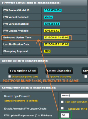

From the same opera cosmetical one: postponement bump 3 –> 30 d., WebUI EUT states the same:
EDIT: P.S. I get it, that until Update-Check doesn't execute, this calc won't either. Yet, some sleepless user/admin might get an unnecessary trigger...

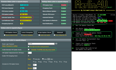

After latests @ExtremeFiretop dev changes, still from old opera another one cosmetical one on "new F/W update" (2nd in row) e-mail:
Hi @kriukas
Every single one of your 7 bug reports (listed below) have been resolved
  1. Added missing changelog patch from previous PR to force 3006 changelogs in an upgrade from 3004 to 3006
  2. Fix Web Access Restrictions by modifying the regex to accept subnets larger than /20
  3. Fix Web Access Restriction being unable to break out of that 8‑bit last‑octet for large /5 ranges for example.
  4. Fix Changelog Verification for firmware jumps from 3004 to 3006.. Previously only checks between 2 matching firmware versions, which won't exist between firmware jumps in changelog 388.8 and 3006.
    Also previously did not flatten the content so word wraps are missed such as:
    "any additionnal GN must be
    manually reconfigured."
  5. Set "Firmware Run Estimates" to TBD when disabling "built-in firmware update checks"
  6. Previously changing the postpone period in the WebUI did not correctly recalculate the new estimate flash time. Now we force it too.
  7. Fixed emails showing an estimated date when the "Enable Automatic F/W Update Checks" is DISABLED

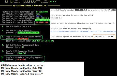

Dear @ExtremeFiretop , @Martinski.
Hope I wouldn't make Friday evening bad, but I was testing this latest Latest Commit - if I D/L the correct one. And here I am testing the GUI Workflow in both realms:
As I do not know the idea behind workflow (if there is one documented), I have found out (from my perspective only), that I do not know, what would happen; what in fact would take the priority:
A. Disregarding the "Changelog Approval" block and proceed immediatelly to the flash.
OR
B. There would be a Changelog block in effect, which would on the second step (choosing yY or OK), would cancel the flash?
B1. If this branch is taken in effect - then why does "ChangeLog Block" hasn't canceled/interrupted the "Run F/W Update Check Now" in the first place (like sub-net check)?
depending of the feedback, I would have an additional info.
EDIT: P.S. all this might be off-road from my side, as I do not know the design idea behind the workflow. Moderator may cancel this post anytime with PM about this. A short feedback message would be nice thought. Thanks!
