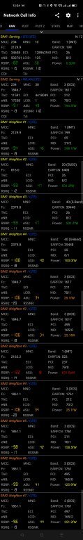

Wouldn't something like Network Cell Info on a mobile phone do the necessary? It shows all the local cells, much better than sim swapping.
Poor image attached due to forum restrictions, but you get the gist. I understand the OP's requirement, but does it really have to be down to the mifi device to do the scanning and gathering the info?
