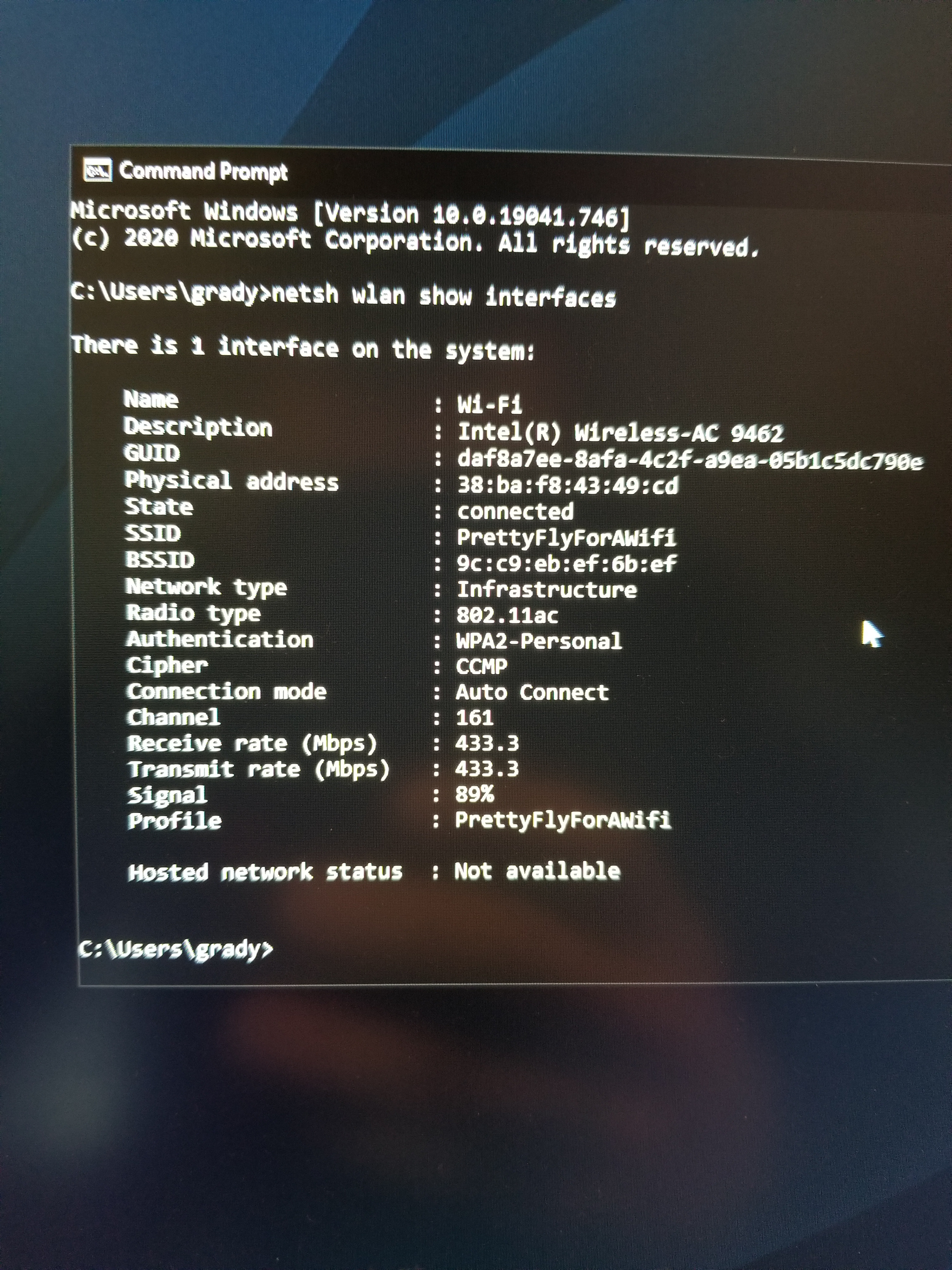

What is Windows reporting for link rate? Open a command window and type netsh wlan show interfaces when you're associated and you should see both transmit and receive link rates

Says I'm getting 433 mbps recieve/transmit but speedtest.net and other tests are below 200 mbps for download and around 240 for upload. It definitely feels slow.
Hmm. If you are using a two stream AC device and are close to the router and the router is set for 80 MHz or 20/40/80 MHz channel width, you should be seeing 866 Mbps link rate.

Could you please post a screenshot of the netsh wlan show interfaces output?
Sorry I didn't see this before.
I tried uploading a picture and it says the file is too large for the server to process? Even though I dumbed down my phone camera to 9 MP.

The Intel 9462 is a single stream adapter. So that's why the link rate is 433 Mbps. That's the maximum AC single stream rate.
So where we are is your wireless upload throughput has increased from 21 Mbps with the old service to 240 Mbps. Download has decreased from 442 Mbps to 200 Mbps.
Given the 433 Mbps maximum link rate of your adapter, I suspect the 442 Mbps test was done over Ethernet. If you didn't disconnect Ethernet when you ran the Wi-Fi test (and vice-versa) that could be the reason.
If you want higher Wi-Fi throughput, upgrade your wireless adapter to an Intel AX200 or variant. Note, however, your notebook might not allow you to do it. For around $20, it's worth a shot.
