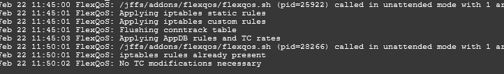

Hello! I am using Gnuton's merlin fork for TUF-AX3000 and I've installed FlexQOS. The problem is that the menu for customizing it is nowhere to be found in the QoS section of the router. I believe I've installed it successfully via the SSH as seen in the screenshots below. Can anyone tell me what to do to resolve this?

See:
Thank you for the prompt reply. But, what do you mean by "...update flexqos.sh to replace QoS_Stats.asp with AdaptiveQoS_WebHistory.asp on this line:" exactly? How do I do that?
Login via ssh and run these commands once:
sed -i 's/QoS_Stats\.asp/AdaptiveQoS_WebHistory.asp/g' /jffs/addons/flexqos/flexqos.sh
flexqos restart
