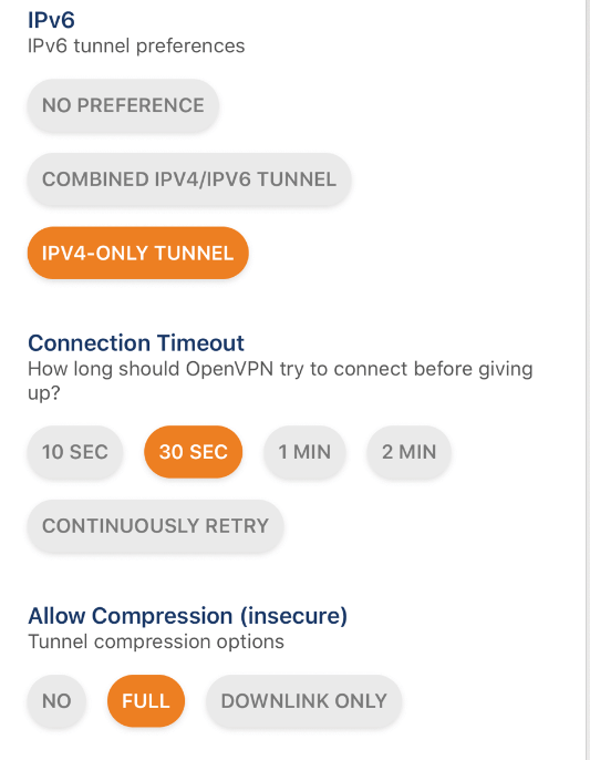

    I do not quite understand what you mean. Guessing: problems with accessing OpenVPN server from your iPhone.
    Check this post:
    https://www.snbforums.com/threads/c...r-r7800-v-1-0-2-64sf.55198/page-5#post-478823
    I.e. you should change the setting of your OpenVPN client on your iPhone enabling "Allow Compression (insecure)" to FULL.
    [​IMG]

    thanks for the reply. When I setup using the router Iphone will not connect. The read me file, has how to install vpn I don't know if I need that. Do I install openvpn like before? Using the router. Or follow the read me using usb drive

    You need OpenVPN server. My README describes OpenVPN client procedure. So like before, using GUI.
