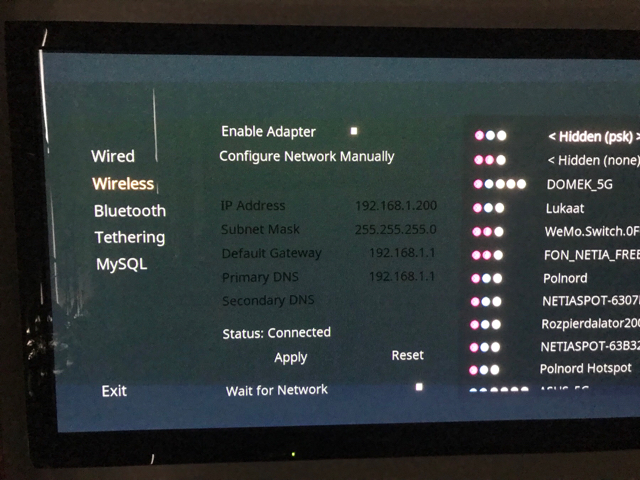

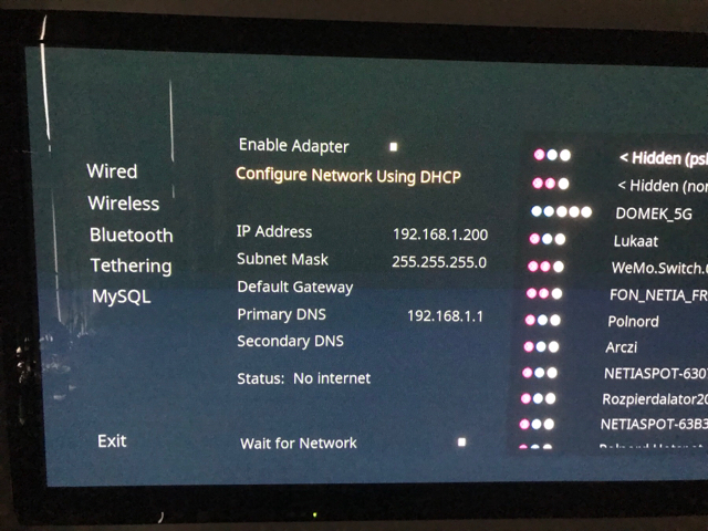

i am facing following problem last days...
I’ve bought OSMC official 5ghz adapter that had improve my connection speed. I installed adapter, connected to 5ghz radio and experience no internet connection. The same issue when connect to second 5ghz radio. 2,4ghz network works perfectly.
But when i use my EA-AC87 media bridge set as AP, connect its to RT-AC5300 and create another 5ghz network, then link The connection between OSMC adapter and EA-AC87....internet works properly...
Is it ordinary compatibility issue or i have something set wrongly?
Disable airtime fairness and MIMO
Are you using separate SSID for the 3 radios on the 5300 or Smart Connect?
I have found if you have the smart connect steering rules set up wrong it can screw up some low speed 5Ghz devices by constantly bouncing them between channels.
