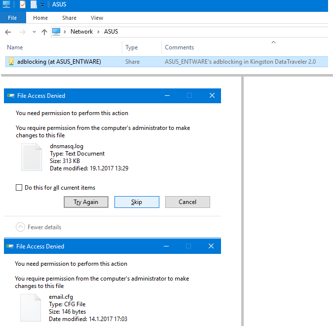

A stupid newbie question:
I have AB-Solution 3 installed and it works great!
Now I decided to make a backup copy of the contents of the adblocking folder (from my external Kingston DataTraveler usb connected to router), and entware folder as well, simpy using copy-paste method (dragging) from Windows 10 File Explorer (see attached picture).
I have configured R/W rights for my current Windows 10 User credentials from my Asus RT-AC68U USB Application - Network Place (Samba) Share / Cloud Disk for the Kingston DataTraveler, but I cannot copy dnsmasq.log and email.cfg files from the adblocking folder. Maybe because I should use the Router login Admin Name and password? But I cannot enter those credentials.
Is it even possible to easily make a backup copy of the contents of the external usb disk (containing entware and adblocking folders)?

The better way to backup is to use UNIX copy. Log into the router using ssh, and copy the contents of the USB thumb drive to a second thumb drive (or USB hard drive) -- user, group, and permissions are maintained.

The dnsmasq.log file is in use by the process and locked.
The email.cfg file is only accessible by the router admin's account, this is the best I could do to protect it from being read by other processes without sufficient privilege.

+1 for this method...i had a USB stick on the fritz, so i duplicated the entire contents across with a recursive copy.
