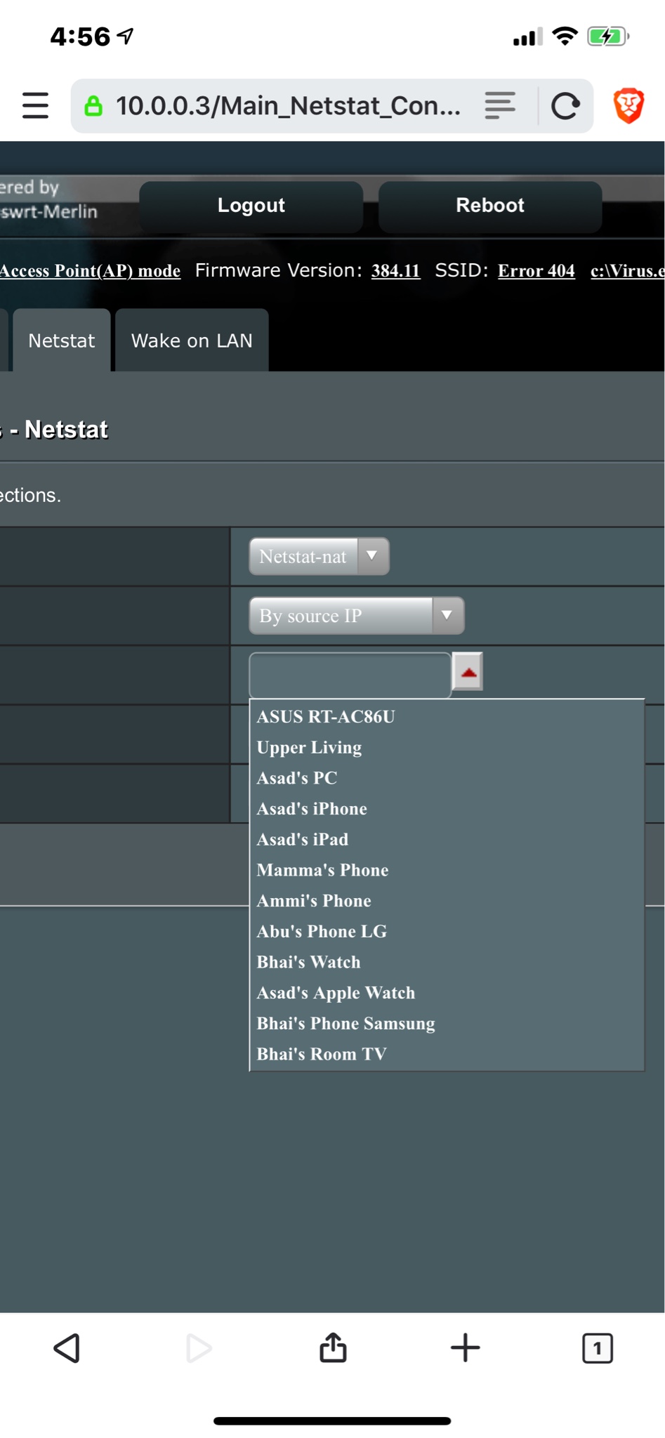

There never was a filter on that page. You must be confusing it with the Classification page (under QoS).
There was and its still there in non-HND routers, see the attached image:
