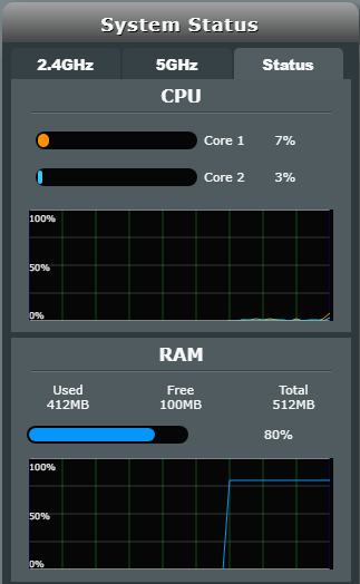

After 13 days uptime of my 86u, gui respond slower, much more slower than earlier. Cpu usage is normal, memory usage is 80%
This seems to be a long standing memory leak in the Trend Micro modules which are closed source therefore RMerlin can't fix it. I solve the problem by rebooting at 2:30am every night using the reboot scheduler, but once a week would probably be enough. If you use FreshJR's QoS script its an idea to reboot a little while before his script does the 3:00am checks that the changes are still applied.
Same issue here. almost 2 weeks without a glitch...than totally impossible to log into. Had to restart twice. Now it works again. I have another issue with reboot scheduler so I will manually reboot every weekend.
