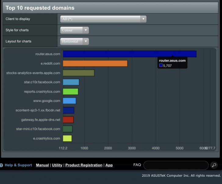

Hi, Diversion GUI within this version of RMerlins firmware is informing me I have over 5,000 hits to router. asus. com
In order to log into my GUI on the router I must enter https: // router. asus. com :8443.
I have no idea what could be causing this and I'm kind of worried it might be something malicious at this point.
I posted this on a separate thread before and was told my browser was causing the issues. I make sure to close my browser and delete all cache every time after I am done logging into the GUI so I can't see this being the reason at this point.
The issue went away by itself but with the newest version of Asus Merlin it has returned.

View attachment 19206 Hi, Diversion GUI within this version of RMerlins firmware is informing me I have over 5,000 hits to router. asus. com
Attached is a photo:
Posting your earlier thread for others to see because it’s probably best to resume your discussion there. Your concerns aren’t related to the 384.13 release.
