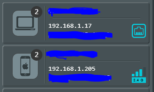

Why some devices are connected twice or are they?
Smart connect on my Note 9 connects to my Samsung 55 TV running TIZEN, so it appears on my AC86U as 2 devices connecting to it.

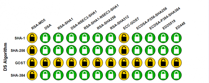

Strange, last month after installing the new firmware I had the DNSEC validation test showing me that most of the DS algorithms are verified in green:
A quick check this morning showed me that it doesn't do that any longer. Here is the latest rootcanary test:
I haven't changed any settings since the first image and second image in the firmware. The reason I checked this morning was to test the new Firefox extension 'Firefox Private Network' that disguises your IP address by sending all traffic through a proxy service provided by Cloudflare (https://private-network.firefox.com/welcome). But that's no the reason for the DNSEC validations to fail on some algorithm since the choice of browser doesn't matter. Does anyone have an explanation of what changed in the last 40 days?

Is it ok if you use another browser? Seems to me that routing all browser traffic through this service is the smoking gun here.
Doesn't Firefox's service you are using use DoH so you are not seeing things correctly?
No, doesn't help. It's the same on Edge or Chrome.
I have DoH turned off in Firefox 69.0. It's not on by default yet, it will be a default setting in Firefox 70.
Could be a change with your upstream providers.
That test is misleading because it doesn't specifically report what YOUR resolver (i.e. your router) supports.
