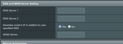

Just updated to v1.0.1 and things work now with no entry in the DHCP - DNS option, just the radio button set to yes, everything works.
