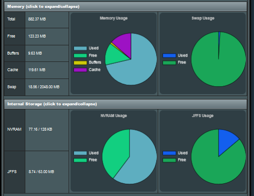

Are you seeing any actual negative effects of having 99% memory utilization? Slowing performance, etc.? If not (and I suspect you won't), then ignore it: Linux and Unix based operating systems tend to be pretty efficient in managing memory and may report "high" numbers like that but still work just fine, unlike Windows.
Right I mean I know how Linux works in this regard. Not my first rodeo so to speak.
And no, no negative effects yet.
What worries me I guess is that the mem usage grows with time and so far on my sporadic checks doesn't seem to ever go down (as you might expect if, for example AGH periodically flushed / cleaned up memory usage).
As you indicate your cache pie piece is larger, this indicates that your memory is properly prioritizing its memory usage (probably as consequence of usage by adguardhome). Which also may indicate why your swap isn't firing at all pistons. Adguardhome itself is not 100% the culprit to high memory usage, but it is the consequence of your router prioritizing memory for AdGuardHome.

This will add the --no-mem-optimization as a starting argument. I suspect this will mean that AdGuardHome will no longer aid in memory prioritization to serve its purpose.
W/o --no-mem-optimiztion
W --no-mem-optimization
While I am not sure if this is indicative of any significance, the platform I ran the --no-mem-optimization test uses the OISD-Basic Domains list for blocking and I do not have Diversion or unbound or any other DNS solution running on it.

Per the other post I just made, I guess my concern is that AGH mem usage just grows and grows with time but never seems to drop which you might expect in some sort of cleanup or optimization situation. I'll try to come up with a better way to monitor. Can always fall back on a daily service restart though.
While I have seen this, I recommend also testing the no memories optimization arguement.
I will get there.
This is getting off topic and I might start a separate thread here, but I now have AGH set to restart every morning. I also have a simple logging task set to record RSS and VSZ usage by AGH every 10 minutes. I've got this logging now with mostly out of the box settings (in regard to mem optimization or cache size or whatever). Will try other settings later.
