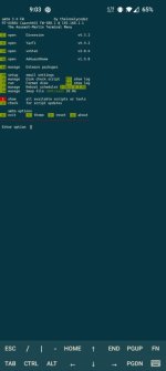

Router rt ax86u. Firmware 288.1
I tried to even uninstall and reinstall, still the same problem.

I presume you mean 388.1.
What interface? What type of connection and speed?
Are Diversion and Yazfi working as expected? Do you have a full install of Entware?
I would recommend updating Entware packages because there are other dependencies in dn-vnstat beyond the ones you tried to reload.
Then force re-update dn-vnstat.

Thank you for your help
Diversion and Yazfi work with no problems.
I updated entware and after that I updated dn-vnstat. Still the same problem.
I basically stacked on December 2022. I have no clue what to do . I am on latest Merlin firmware.

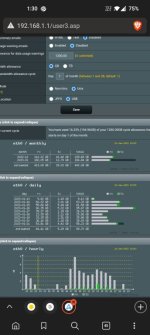

I don't know that did you mean by what kind of interface I use.
I have Xfinity blast 800down 20upload
I already uninstalled vnstat and reinstalled. I don't care if loose any data, however the problem still there.
I just re-read your initial post. Did you run the full command opkg remove vnstati2 libgd libwebp && opkg install vnstati2? Because if all you ran was remove, then you need to reinstall the missing apps.
So try this: force an update with uf, then run the above at the command line, then reboot.
If this doesn't work, you may need to go the reset route.

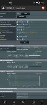

Thank you again for helping me.
Yes, I ran those commands
However...
That's funny. I uninstalled it again yesterday.
Waited 24hrs. And installed it again.
Here what I got. That's mean it is working?

It would appear so. Glad you got it working.
