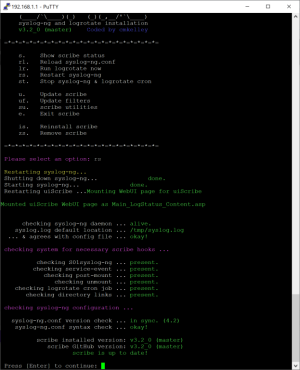

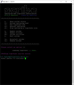

I am running Scribe with Entware.
Sometimes my cron job messages don't make it to the "messages" file for stretches of time, then it's all fine again for a while. Here is an example of a cron job that I want to output to messages every 15 min:
cru a temp "*/15 * * * * /jffs/scripts/temp_check  2>&1 | tr -d '\n' | /usr/bin/logger -t Temp"
I tried to fix this with a couple of reboots for a couple of days, still no go, nothing changes. But yesterday night something happens at 22:39+, a bunch of messages in the log appear, and it suddenly starts working again, no reboot. See this chunk of the log at that time. Any possible clues what might be happening?

try running option 'lr' within scribe, then post the terminal output here (screen shots preferred). Next run option 'rs' in scribe, post the output here as well.
example of what the output of 'lr' should look like:
example of what 'rs' should look like:
Here is the output, as requested.
interesting.... Your scribe is reading from /tmp/syslog.log, instead of /jffs/syslog.log.... Welp, I don't see any errors, but I am not sure /tmp/syslog.log is a persistant place to read logs from since /tmp is a volatile location on our routers.
As the script notes, random routers natively write to /tmp/syslog.log instead of /jffs/syslog.log. Scribe on install figures out which and stores it, so that when it exits and restarts the native logger it restores the location. At least I think thats what I recall from the discussion.
And just to be clear, scribe is the installation/management script for syslog-ng. It kills the native syslogd and starts syslog-ng. syslog-ng reads from /dev/log and /proc/ and writes to files typically at /opt/var/log, including messages. It doesn't read from /jffs/syslog.log or /tmp/syslog.log.
I think the OP's problem might be that something is restarting klogd or syslogd while syslog-ng is still running, leading to a race over which is harvesting which messages from the sockets.
I am curious as to what service (or script) is restarting klogd or syslogd. Are there any scheduled maintenance that scribe does with syslog-ng and logrotate where their services may be stopped log enough for klogd or syslogd to creep their way back into existence? I notice when issues like this happens when AGH is running, it causes AGH not to be able to determine the appropriate interpreter (log facilitator) of the sockets. It causes AGH to either not start/ or to completely crash. I am wondering if dnsmasg log-async also has such issues.
