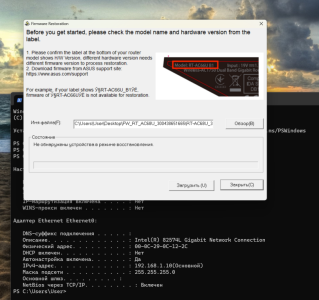

but ASUS Firmware Restoration No view my device :( Please help. What i can recovery my device ?

Yes, you can see in my screen shot that I'm using
192.168.1.10
ASUS Firmware Restoration does not seen the router at all ethernet cable is connected to port #1 of the router.
If you haven't done so already, as a troubleshooting step, try networking ports 2, 3 and 4 along with using different Ethernet cables to rule out port or cable issues. If you have any other computers or USB drives connected to the router, disconnect them so only the one single PC used to upload the firmware is connected.
