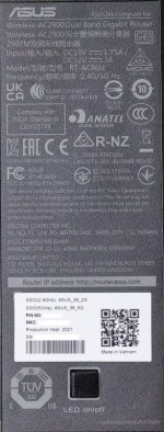

I ordered a RT-AC86U router a couple weeks ago from Amazon and it worked ok for a while, until I cleared the cache of Web History and since then Web History doesn't work anymore. I don't really need it and I went on using the router. Now I did reset the router and all of a sudden the USB 2.0 port stopped working (it shows up in the routers hardware, but Windows can't read the name of the drive and pops up an error message - on all three computers attached to the router. A day after the USB 3.0 port did the same thing. Then I wanted to know what hardware version the router is and I couldn't find anything on the device (picture attached). I'm just wondering if anyone else had similar problems with this router and if there is a fix.

All AC86U routers I know about are h/w revision 1.5. With stock Asuswrt you need to enable SMB 1.0 in Windows. Some services do lock up on this router due to recently found NVRAM read error in software, perhaps. It does have low reliability history indeed. Replace it when you have a chance.
Thanks for your help Tech9. I have here a clean installation (1 week ago) of Window 11 home 22H2 and SMB 1.0/CIFS Automatic Removal and SMB 1.0/CIFS Client is enabled. I will try to get a replacement.
