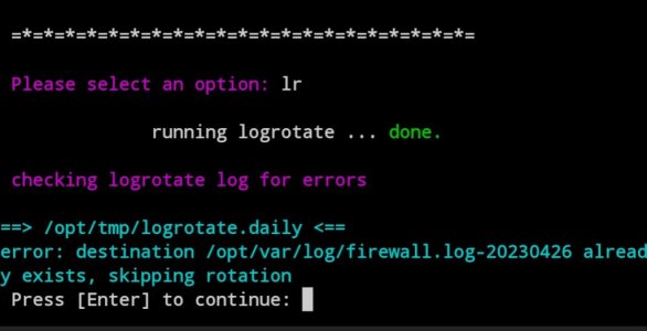

Since updating to 3.0.0 and further to 3.0.2 uiscribe is extremely laggy - as in sections of the General Log page going missing when I scroll and returning after either around 10 seconds or a manual refresh. Is this a product of the changes to scribe or is uiscribe due an update?
The above is constant no matter what I try.
In my experience (because this often happens to me) this is almost always a logrotate problem. Any log file over 1mb is going to bring everything other than messages to a halt, even if you are not showing it.
I've reinstalled both with no change. However, with this advice I've disabled firewall logging as that's the log file with the most activity (the others are lucky to get thirty entries an hour). Will see what happens.
Might it be caused by slow USB flash drive? I suggest using real SSD USB drive or SSD drive installed in USB enclosure rather than cheap USB flash drive.
I have a Kingston SSD running right now (for about 6 months) so I can't see that being the problem. I never had an issue until the 3.0.0 update. I did a rebuild for the 388.1 merlin firmware but skipped it with the 388.2
ETA:
First time I've seen this. It's repeated over and over in the logs.
Apr 26 15:53:37 ripshod syslog-ng[28253]: syslog-ng starting up; version='3.38.1'
Apr 26 18:07:16 ripshod syslog-ng[28253]: The current log file has a mismatching size/inode information, restarting from the beginning; state='affile_sd_curpos(/var/lib/logrotate.status)', stored_inode='61692', cur_file_inode='911502', stored_size='208', cur_file_size='253', raw_stream_pos='0'
Apr 26 18:07:16 ripshod syslog-ng[28253]: The current log file has a mismatching size/inode information, restarting from the beginning; state='affile_sd_curpos(/opt/tmp/logrotate.daily)', stored_inode='6293400', cur_file_inode='6292495', stored_size='0', cur_file_size='88', raw_stream_pos='0'
Other logs are mentioned too.
ETA:
Fixed with a reset and minimal install. Gonna add things back no and check, but panic over.
ETA:
Almost looks like corrupted external disk...
I think you're right. I've reinstalled virtually everything and it hasn't missed a beat. These logs are sooooo quiet now it's a little unnerving.
Thanks for your hard work @cmkelley!
