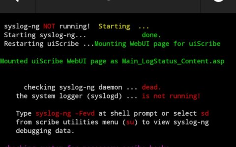

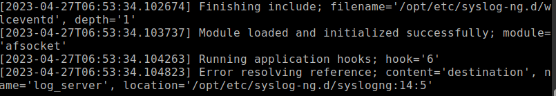

The plot thickens. scribe isn't running. After a reboot it's not running.
'rs' from amtm and it's still dead. 'scribe restart' from the console and it's still dead. Also ran 'sd'.
Very strange. Do you by chance have a funky flash / SSD drive name? Any special symbols or anything? As I recall, some "legal" characters can cause issues. I personally limit myself to a thru z and 0 thru 9, with no spaces even. I know there are more legal characters but I prefer to avoid them.
Assuming you haven't a funky flash / SSD drive name, the next thing I would suggest is uninstall scribe, reboot, and reinstall. Your entware installation is standard, right, no funky custom changes to it?
If the problem persists, about the only thing I can suggest at that point is to run 'd' from the scribe utilities menu and send me the debugging file it generates.
