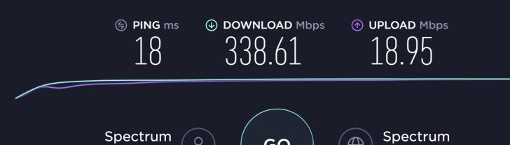

Here's my update. I agree with L&LD's general observation about 10% low with 1 caveat. Any testers times, pings, and results will can vary widely based on the targets chosen, time of day and other workloads on the pNW routing infrastructure at your ISP. Just select an alternative target in speedtest.net (one closer or further away) and it's that many more hops your packets must transverse. So if we picked the same servers as speedtest.net, we might nearly identical results.
IDK if picking the same servers as speedtest.net (or whatever test you want) is feasible or even possible.
From speedtest.net
339/19Mb/s, ping 18 ms
262/16Mb/s ping 80+ms
From speedtest.net
RT-AC86U capture View attachment 17011
I was able to choose the exact same servers as when using speedtest.net on my computer. Very different results. ;)
