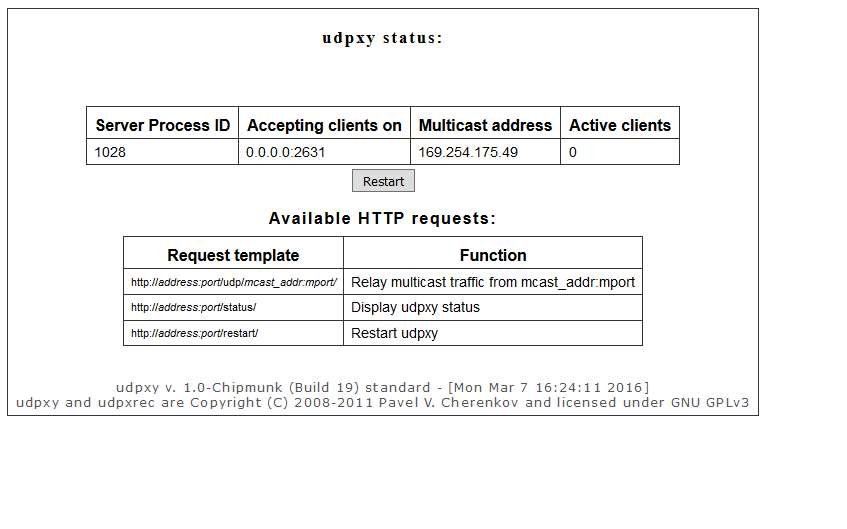

this is a link for watching IPTV from my ISP
http://192.168.200.1:2631/udp/232.2.3.135:5002
with firmware 380.57 if i put that link to VLC player or Kodi can watch tv channel.....with latest 380.58_alpha3 got just black screen......
if i put
http://192.168.200.1:2631/status
in browser i got udpxy server with statistics.....but with all 380.58 alpha versions IPTV from udpxy not working anymore....
