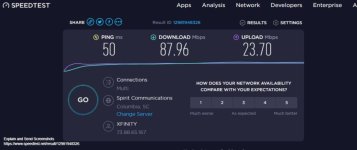

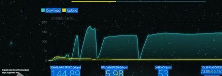

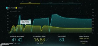

I just rearranged my home a bit. The Archer C7 works well, up to about 20 feet then start to fall, on the same floor of my home. 2600 square foot, 2 story.
The router is downstairs in living room, above fireplace..
All the electronics were moved upstairs for a room for the kids.. So, one is a N based wifi blue ray player with netflix etc. The other is a not smart tv with Firestick 4k, which is AC I believe.

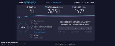

I went upstairs to check the speeds using my AX based laptop, and with door shut, the internet speed almost shut down. Door shut, the testing sites wouldnt even connect. If I open the door, speeds were livable.. Here are some screen shots in the room of the two sites I used. Downstairs and then in room with door open. Speeds look okay, but, when downstairs things loaded much quicker.. Door is 25 feet away and not directly in view of router, but close to a straight line of site.
The thing that concerned was my laptop couldnt connect with door shut while in the room, but everything is fine with door open, which it Wont be when kids are in there.
  • Screenshot of Speedtest by Ookla - The Global Broadband Speed Test (1).jpg

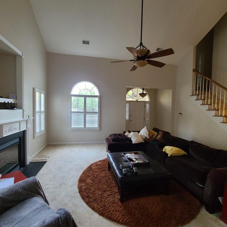

Floor plan is 19 x 20 downstairs. Stairs, 12 steps standard 6 to 8 inch lift are directly across living room going up to the FROG, with a short 3 foot wall blocking the door at the top of the stairs. Walls a sheet rock. as well as ceiling. Floors are hardwood, from living room up to the FROG.
Plan is Xfinity 600Mbps down, 20Mbps upload. I have coax going into a SB 8200 Motorola modem, then Cat 5E to the router..
Channel widths on 2.4 set on auto, 5 is on auto within AX210 adapter. . Within TP Link 5ghz is channel 48 and 2.4ghz is auto.
RG6 feeds the house..
You can see the layout of the room, and how the door on the top right is somewhat hidden by wall.

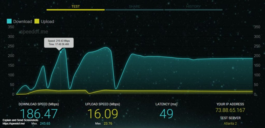

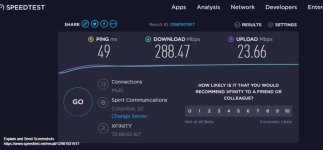

I did a wifi scan of the area.Apple didnt work, so I used insidder and wifinfoview utilities, and I put my 2.4 ghz on 20 only and the channel with the least amount of people on it, 8 which also had the highest signal strength.
Here are the newest results. I think it is better now.
that was with the door shut ?
