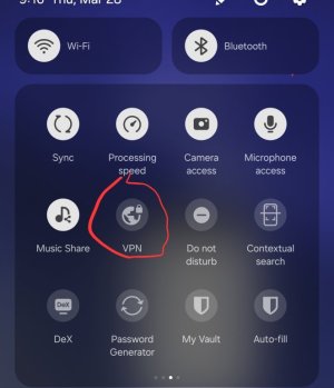

Mine is two clicks as well. First click connects my phone to my router's vpn server:

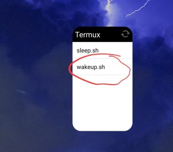

Second click starts a script that commands the router to wakeup the pc:
Let me know if you are interested in more info.
