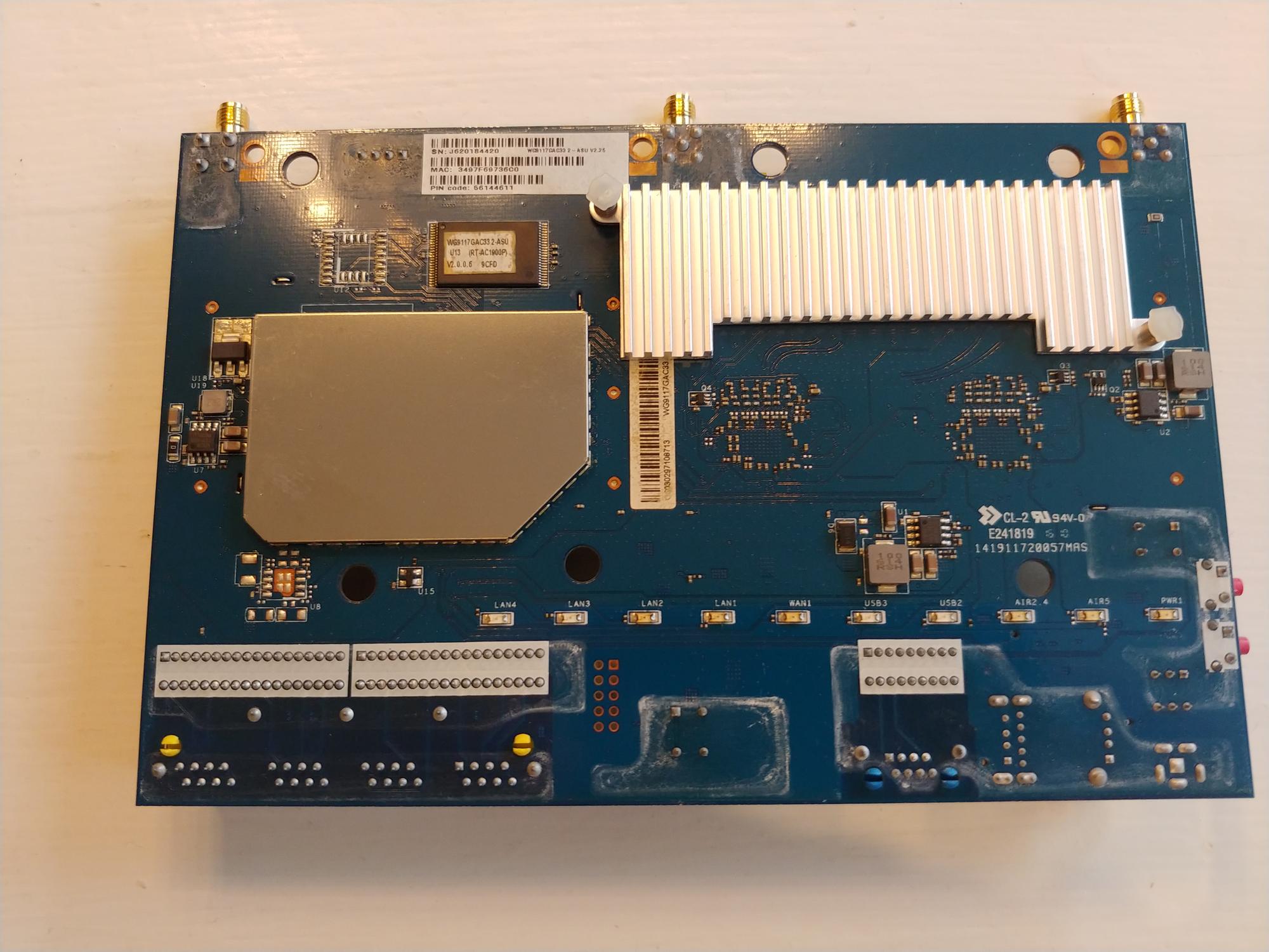

I did take the time to crack the unit open and I see two things that alarm me.
1. The white corrosion on the back of the mainboard.
2. What looks like a fluid stain on the heatsink.
Did this thing get wet sometime in its life?
