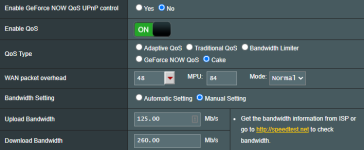

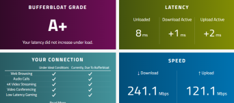

I suggest you simply stick to the suplied Cake-Qos within the firmware.
Try it with speed settings at 100% of your supplied capacity 112up and 330 down [Cake will throttle a small amount - no need for you to]
I have 125up and 250down fibre and always get A+ for Bufferbloat with near full speeds both up and down.
EDIT: Test here ... https://www.waveform.com/tools/bufferbloat
