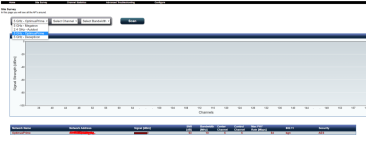

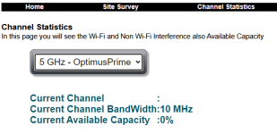

However, when I use the WIfi Radar / Site Survey feature it detects the 6 Ghz as a 5 Ghz network, and the SSID properties for 6 Ghz have vastly different Channel Bandwidth values. I have 160 Mhz configured, but only 10 Mhz is detected during the site survey. Anyone else have similar issues?

It would appear that you mislabeled* your 5GHZ with 6GHZ. Site survey works just fine you just need to enable data collection to see any data
Not sure I understand. I do scheduled data collection every Sunday.
As far as I can tell, there is no way to edit the bands "labels".
When I look at the dropdown on the site survey page, it shows three 5ghz bands. My 6ghz band is showing as 5ghz for some reason.
If you look closely, the channels appear to be for 5ghz and the bandwidth is showing as 10mhz, despite it actually being 160mhz.
To me, this appears like Site Survey hasn't been updated to handle 6ghz bands. I'm on the latest Merlin firmware fyi.
