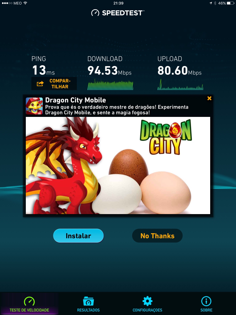

Hello.
I'm using the list adsbegone! and in the Speedtest app for iOS at the end of the test it show advertising!
Strange with the list I'm using, do not you think?
Hello.
I don't think this ad is strange. They likely serve it from their own servers.
Plus, it's a lovely ad, not as abnoxious as others...
I never got any ads when using speedtest app on my phone with ab-solution....
That might depend on what blocking file type is used.
It seems strange because adbsbegone is my list with other lists, and with my list the speedtest is clean on android.
