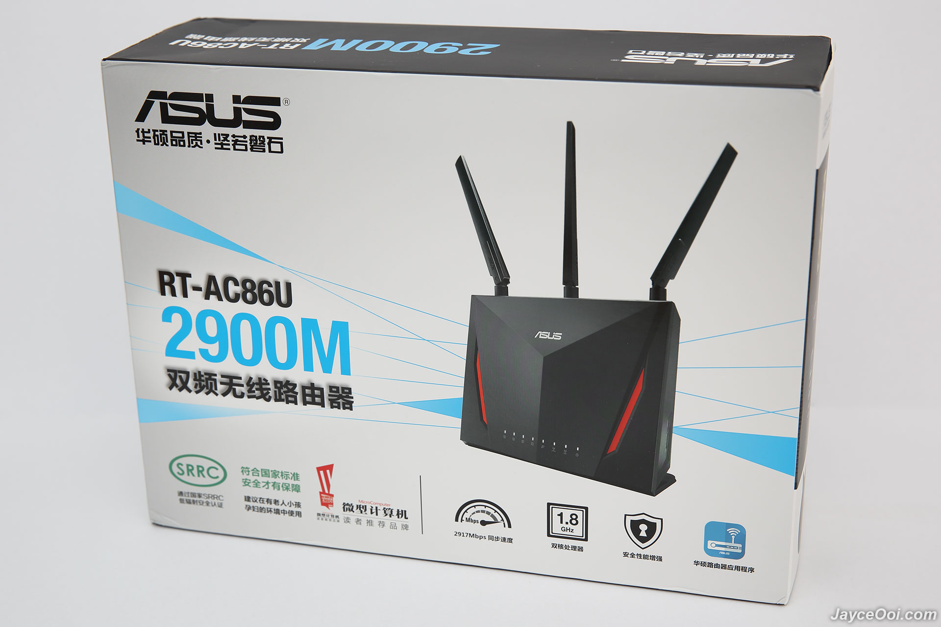

One question, are you guys routers the Chinese version of it? Mine is and i have this problem as well... Another problem that i have is that sometimes my router reboot itself when i disable and enable again the lan on my desktop computer, the only computer that i have connected using a cable.

Chinese version is the one that you buy strait from china like from sites like aliexpress, gearbest and etc
The box looks like this:
With Chinese writing in it.
Then NO, mine came in a black box, purchased from ASUS Canada.
Aren't they the same hardware devices? Different packaging has nothing to do with the issue.
And I didn't know there was a "cheaper" version of your router (and that possibly they are the ones affected).
Nothing to do with the "cheaper" chinese version, hardware is exactly the same, only different cfe settings to allow using different WiFi-region setting and power plug, thats why I prefer to call it the international version. They sell to different regions for different prices, thats all ...
Now chinese version will cost same as for other regions.
And I had it with stock an Merlin, but much less with last firmwares than at the beginning.
Maybe there are dependencies to region because of different cfe default settings, who knows.
