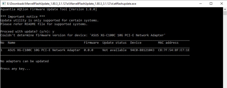

Somehow it doesn't allow me to update?

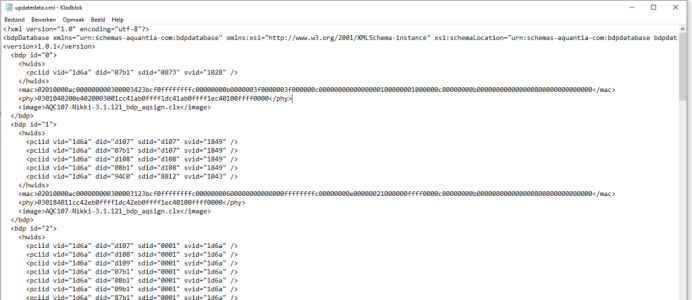

UPDATE:
Got it working by simply deciphering my hardware IDs from Device Manager. I added:
<pciid vid="1d6a" did="07B1" sdid="B912" svid="1462" />
To the updatedata.xml file. All seems to be smooth and working.
I also have the Asus XG-C100C V2, but don't manage to update it. I downloaded the MarvellFlashUpdate_1.80.3_3.1.121a file, opened the updatedata.xml using notepad. Added the info from the asus card but still get no adapters can be updated message. See attachments. What am I'm doing wrong?
