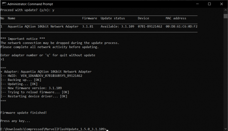

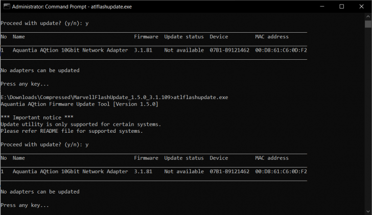

Somehow it doesn't allow me to update?
MSI 10G SuperLan card.. pretty sure it's an Aquantia made one.. the drivers are just stock Aquantia drivers?
UPDATE:
Got it working by simply deciphering my hardware IDs from Device Manager. I added:
<pciid vid="1d6a" did="07B1" sdid="B912" svid="1462" />
To the updatedata.xml file. All seems to be smooth and working.

UPDATE:

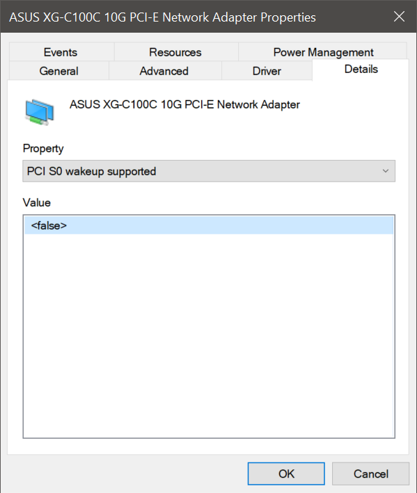

Glad you got it to work! The "Device" field above gives you all the values you need (though non-intuitively).

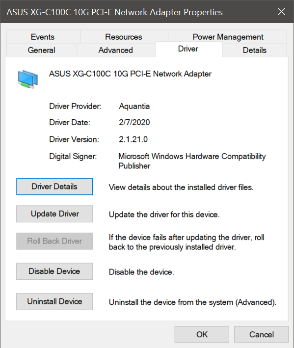

I can't with MacOS but for Windows 10, make sure you're on driver 2.1.21.0 (or newer).

Thank you so much for the detailed info! The version of the driver in windows 10 V2004 is 2.1.21.0. But the three options on Power Management tab are grey, I cannot click any of them. Also, on the Advanced tab, these five option you showed are not there, cannot find them. Link State Power Management had been turned to "Off". My motherboard is GIGABYTE Z390 M Gaming, ErP is disabled, there is no Power on by PCI-E on my BIOS, but there's a peg asom option, I turned it off. When my system is asleep, the NIC link is down (the NIC lights is off on my switch). Don't know what to do next : (
Have you tried reinstalling the 2.1.21.0 driver directly off Marvell's website?

I pulled the XG-C100C out of my Linux box and threw it into a Windows 10 system and, sure enough, the WoL functionality is software-disabled. The card supports it, but it is disabled via the aqnic650.inf settings that come as part of the Marvell driver bundle.
The relevant section of the .inf file is:
%Asus.XG.DeviceDesc%             = Atlantic10G.Asus.XG,     PCI\VEN_1D6A&DEV_D107&SUBSYS_87411043&REV_02
%Asus.XG.DeviceDesc%             = Atlantic10G.Asus.XG,     PCI\VEN_1D6A&DEV_07B1&SUBSYS_87411043&REV_02

Sorry to burst your bubble, I too have that Asus card and after rigorous follow up with Asus and Aquantia reps, they both made it clear that XG-C100C does NOT support WOL correctly as it is missing the required Circuitry as per WOL specifications.

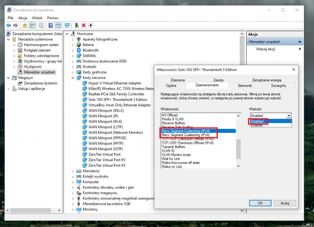

firmware 3.1.118 has been released with no change log, I am hoping it resolves the issue when the AQC107 randomly stops responding to all data communications when it transfers files between my realtek NUC and my main PC. This issue was just as reproducible with my old main PC build, it is either a FW or driver bug. Only workaround it to keep disabling/re-enabling the Aquanita in device manager when it happens, it did it 3 times today and other times it doesn't do it for months.
I've watched some videos that disabling "recv. segment coalescing" function helps with such problems.
