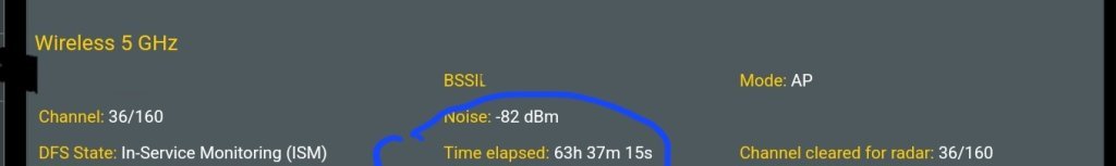

Well, 3 days after reset.
Wireless uptime not get resetted, hurray!
Im happy. So happy.
Merry Xmas guys!
