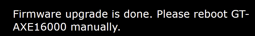

On item of interest, after each of the 388-5 Alpha/Beta/GA updates on the GT-AXE1600, this message would be posted on browser panel after GUI invoked update.
With the first Alpha I just ignored, to avoid further disruption to the 50+ clients/devices at home. Then within 24-48hrs most of my seven Roost Water/Heat/Humidity units started dropping offline. If you manually re-connected them again, most dropped out again over 24-48hrs. Powered off/on the Router after the second Alpha and still no better. What did resolve the Roosts dropping out, was powering off/on the AXE16000 I have as a AiMesh unit.

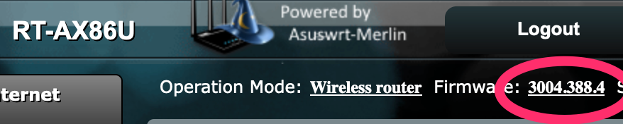

The firmware upgrade doesn't seem like it's working for me.
I've got an RT-AX86U (currently running 388.4 uploaded in last October, I believe).
I had downloaded the .zip file from sourceforge, verified sha256 through macos terminal and compared it with the asus-merlin download page.
Hello,
I uploaded the pureubi.w file and numerous times I get this:
Sometimes the firmware upgrade asks me to manually reboot my router after the "unsuccessful" attempt (see first screenshot). Sometimes it doesn't.
I've logged out my router, cleared my browser, restarted my browser. I've redownloaded the sourceforge .zip file.
But the router webUI always shows the firmware version as 388.4
Anyone else having this issue?
-A
Um, yeah... I did read through the thread, but I didn't think I got a clear answer from someone who successfully broke through the same problem as me.
Second, I do not USBs on my router, but I do have mesh. And I have tried to upload via ethernet a few times earlier (I forgot to mention).
And, I don't know what "dirty flash" means.**
**edited: ok, i looked it up. going to try it now.![]()
