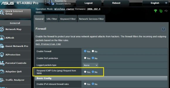

RT-AX-86U Pro 3006.102.4
The ShieldsUP scan of Common Ports says FAILED because a a Ping (IMCP Echo) reply was received. The Firewall setting, Respond IMCP Echo (ping) Request from WAN, is NO. Any issue with this behavior?

Not seeing the same on a RT-AX86U Pro. All common ports report stealth. Respond ICMP Echo (ping) Request from WAN is set to No.
GRC Port Authority Report created on UTC: 2025-06-01 at 22:xx:xx
Results from scan of ports: 0, 21-23, 25, 79, 80, 110, 113,
                            119, 135, 139, 143, 389, 443, 445,
                            1002, 1024-1030, 1720, 5000
    0 Ports Open
    0 Ports Closed
   26 Ports Stealth
   26 Ports Tested
ALL PORTS tested were found to be: STEALTH.
TruStealth: PASSED - ALL tested ports were STEALTH,
                   - NO unsolicited packets were received,
                   - NO Ping reply (ICMP Echo) was received.
Edit to add: Are you running any addon scripts or have made any changes to the router or it's firewall (etables or IPtables) rules? Or is the upstream ISP provided hardware the router is connected to maybe responding somehow to the GRC test? Maybe the router log will show something?

Are you perchance testing through a VPN?
I ran ShieldsUp through my VPN (wireguard, running on the router) and it detected the VPN endpoint IP, not my actual IP, and gave passing grade on all service ports, but also indicated PING fail due to response. My Firewall settings are set to Not Respond.
