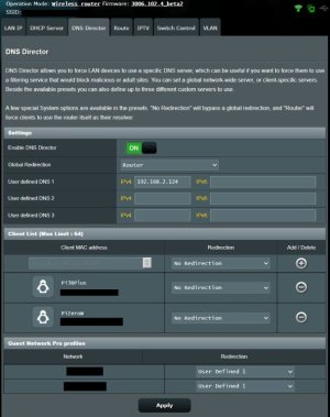

Cannot comment specifically on Diversion or Skynet because I do not use them. However, I do use Pi-Hole on the local network, and using DNS Director, I do have my Guest Network Pro IoT Profile's using the local network Pi-Hole's for DNS resolution. So I would assume one could configure the same for Diversion and Skynet possibly either in the Guest Network Pro Profile's DNS field or in DNS Director if one needs to assign Diversion/Skynet explicitly.
