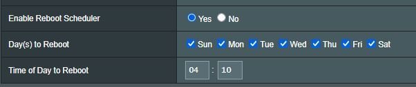

Reboot scheduler stopped performing the scheduled nightly reboot 3 days ago. It had been working reliably and rebooting each night for the past few weeks since installing 3006.102.4 No users are complaining about network access. Everything else seems to be working as before. I will power cycle, then check in the morning to see if that fixed it.
This is the end of the last info in the syslog:

Jun 15 04:12:42 crond[3134]: time disparity of 764831 minutes detected
If there are any clues to look for in the hundreds of logged lines on each reboot, let me know.
Did I just encounter a "well known bug" with scheduling in Administration? That would be a "bug" that I never encountered previously with RT-AC66U_B1 running 386.14.2 and scheduled to make the same nightly reboot, which worked reliably for many years.
I don't think so. IIRC that "bug" only effected the RT-AC86U and it resulted in the router being powered off. That's not the same symptom that you're reporting.
Power cycling brought the Reboot Scheduler back to a working state (though I need't have bothered as an hour later a few short power cuts did the job all over again). Looking forward to 102_36957 - thanks @RMerlin
