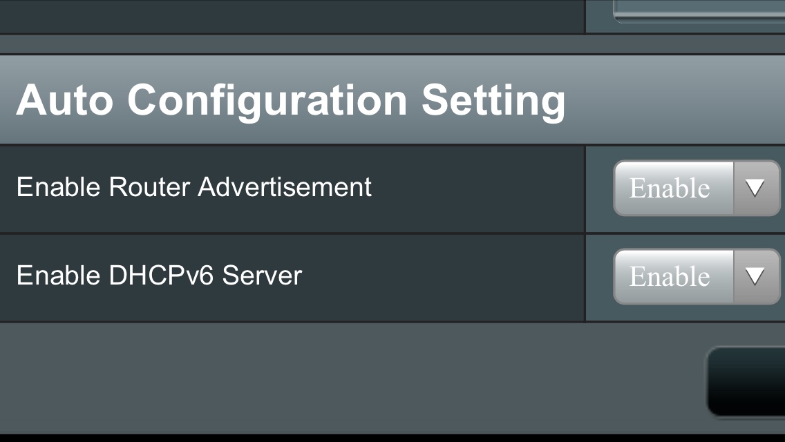

Has anyone noticed IPv6 being broken on this firmware when connecting OS X devices? My windows PC and Android tablet are assigned IPv6 addresses, and work properly; however, my work Macbook Pro running OS X 10.10.4 is assigned what seems to be local IPv6 addresses but when I attempt to visit ipv6.google.com it can't resolve the address, and if I try http://ipv6-test.com/ it fails the IPv6 tests. I should also note that this device doesn't appear under "System Log > IPv6".
Anyone know what the issue might be?
Hmm, no problems on my Mac devices...
