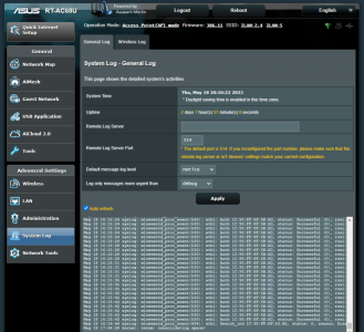

RT-AC68U Dirty upgrade from 10 to 11 via wifi network with antivirus program on works perfectly for 2 days and 7 hours without problems ;)
